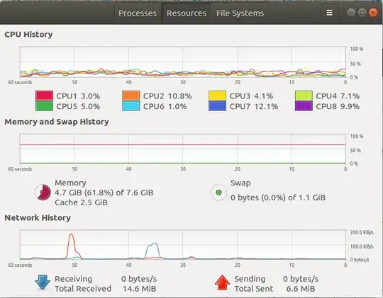

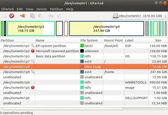

I've dual-booted my laptop with Windows 10 and Ubuntu 18.04. While installing Ubuntu, I created a swap space of 15GB. My laptop has 8GB RAM. I hadn't noticed earlier, but now that my system is running out of memory, I noticed that System Monitor shows only 1.1GB swap. Turning off swap and turning it on doesn't help either. What is happening here? How can I fix it?
gparted snapshot
system monitor snapshot

Following KGIII's comment, I fixed it as follows
Check if /swapfile is being used instead of swap partition
$ sudo cat /proc/swaps
Filename                Type        Size    Used    Priority
/swapfile                               file        1158220 0   -2
Now, to change swap from using /swapfile to partition, I followed this blog. Although it does the reverse, the required commands are available.
Turn off /swapfile
$ sudo swapoff /swapfile
Edit /etc/fstab file to use swap partition instead of /swapfile. Commented existing line and added new line. UUID can be obtained from gparted (right click on swap partition and select information)
UUID=530e52cc-8a1d-400b-bbde-b47c0246586d none            swap    sw              0       0
# /swapfile                               none            swap    sw              0       0
Format the swap partition
$ sudo mkswap /dev/nvme0n1p8
Set swap to use the partition
$ sudo swapon /dev/nvme0n1p8
