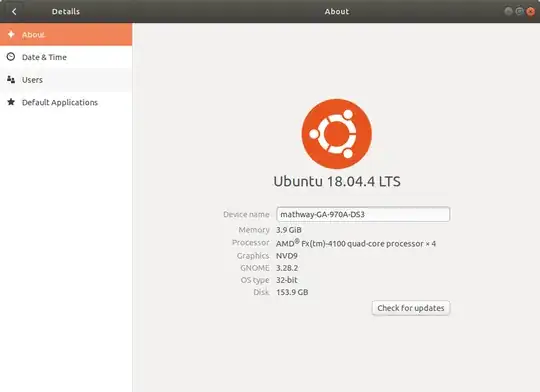

uname -a output:
Linux mathway-GA-970A-DS3 4.15.0-112-generic #113-Ubuntu SMP Thu Jul 9 23:41:06 UTC 2020 i686 athlon i686 GNU/Linux
Screenshot

There is no Ubuntu 18.04 LTS desktop ISO, that was announced years ago and hasn't changed (wasn't any for 17.10 either).
Yes, Ubuntu 18.04 LTS is supported on x86 (flavor ISOs exist, plus netboot), but there is no i386/x86 desktop ISO except for amd64.
Some flavors (e.g. Lubuntu & Xubuntu) supported 18.10 fully for x86, and even continued into the 19.04 cycle for alpha ISOs (last ISO was very early Dec-2018 for Xubuntu, late Dec-2018 for Lubuntu) which had you installed either, your system would have had all upgraded packages for the life of 19.04.
The x86 upgrades were disabled completely just prior to 19.10's actual release (https://bugs.launchpad.net/ubuntu/+source/linux/+bug/1845714)
If you're using x86/32-bit though, your best supported bet is 18.04 LTS, as it'll have 5 years of support for main repository (server, default desktop) and 3 years for flavors.
