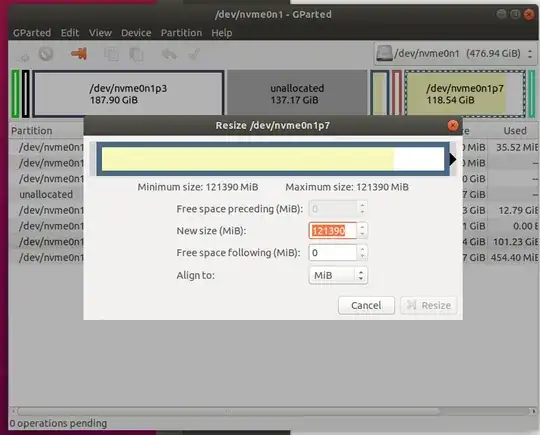

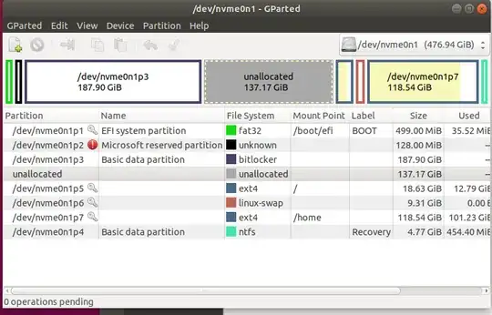

I have a dual boot with Windows and Ubuntu. My Ubuntu was lacking space and free some from the Windows partition. Now I want to expand the Linux system, but GParted does not let me do it. How to expand it?
I logged in with Windows and tried to resize with the "EaseUS Partition Master 13.5" tool. Same. I could not do it.
Your partitions are locked because they are in use by a running system. You need to boot into a live environment and run GParted from there. You can do this with your Ubuntu install media.
