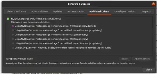

Adding Software & Updates screenshot
Software & Updates

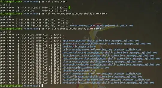

crash files, gnome shell extensions listed in terminal

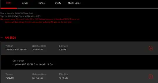

BIOS
MSI B350 Tomahawk
You have BIOS version 1.L0, dated 12/28/2018.
There's a newer BIOS available here. The numbering/naming convention is different than what you have now, and that's unusual. Contact MSI Support and ask about this.
Note: Confirm that I have the correct web page for your model motherboard.
Note: DON'T download/use/install the most current BETA version.
Note: Have good backups before updating the BIOS.

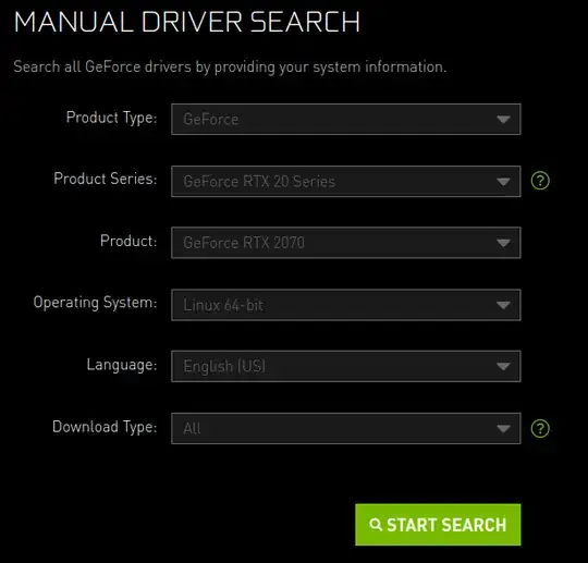

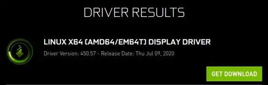

Nvidia
You have Nvidia version 440.100.
Software & Updates shows that this is the current version. However, there's a newer version 450.57 which can be downloaded here.
Note: Have good backups before updating the Nvidia drivers.

Install the BIOS update... but contact MSI Support first, to confirm which BIOS update file version you need... as their naming convention seems to have changed.
You have installed a number of GNOME Shell extensions, any of which can cause freezing, and they're installed in the "wrong" place, in so far as they're installed system wide, as apposed to user-specific. You can see them in the /usr/share/gnome-shell/extensions directory listing, and they all end in gcampax.github.com.
The safest way to remove them is to go to https://extensions.gnome.org/local/ and delete all but these three extensions...
drwxr-xr-x 2 root root 4.0K Jun 11 08:20 'desktop-icons@csoriano'/
drwxr-xr-x 3 root root 4.0K May 12 15:17 'ubuntu-appindicators@ubuntu.com'/
drwxr-xr-x 3 root root 4.0K Jun 18 09:12 'ubuntu-dock@ubuntu.com'/
If the system runs ok without freezing for some period of time, then manually reinstall any single favorites, one extension at a time, rather than installing extension packs/zip files.
