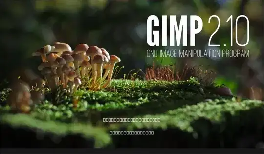

My install of GIMP is suddenly crashing on startup.
The launcher window opens and runs through it's setup process, but the font is all messed up (see screenshot).
The same boxes show on the main GIMP window, which opens for a second, then closes.

I too faced the same issue. running the following commands to clear fontcache from the system solved the issue for me.
Commands:
sudo rm /var/cache/fontconfig/*
rm ~/.cache/fontconfig/*
fc-cache -r
Turns out this is an issue with snap.
