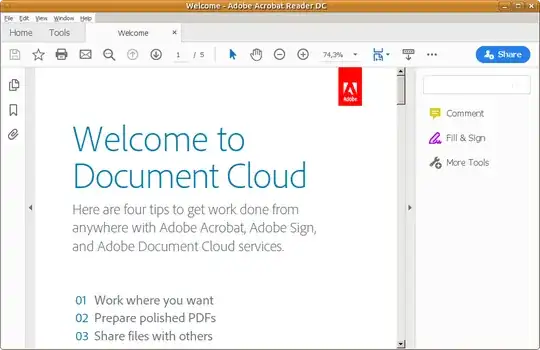

In the PlayOnLinux window select Tools → Run a local script and specify path to it (
~/Downloads/acrordrc2020.pol), confirm its execution and wait it to finish.Set file association for PDF file with Acrobat in PlayOnLinux by choosing Settings → File Associations, then click New, enter .pdf and associate it with Acrobat in the bottom of window.
Open file manager, select PDF file and use Open With to get it opened using newly installed Adobe Acrobat Reader DC.
Enjoy:
