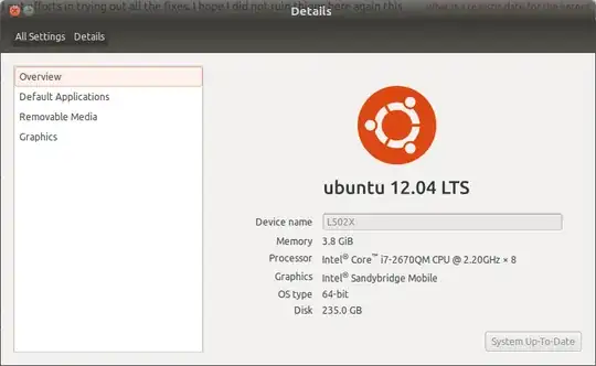

Know that The Nvidia card is not compatible with Unity 3D. The Intel HD 3000 is. That means that if you're using Unity 3D now, it's the Intel card which is in use. And the fact The Graphics Driver name does not appear in Systems Settings (Details), stipulates there is some conflict between drivers (Proprietary drivers of Nvidia or Nouveau). Purging them and reinstalling bumblebee seems a solution (Bumblebee will resintall Nvidia drivers nvidia-current for you). The correct result should look this:
System Overview OR: Graphics used

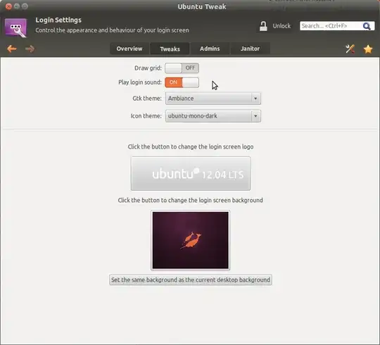

For your other tweaking needs. As you're new to Ubuntu, the best way to achieve some tweakings for your whole desktop is to install the application: UBUNTU TWEAK, this way:
sudo add-apt-repository ppa:tualatrix/ppa
then
sudo apt-get update && sudo apt-get install ubuntu-tweak
Ubuntu Tweak Login Tweaking unlocked

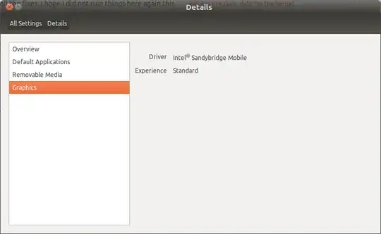

Then, I found this telling us to install mesa-utils in order to fix "Graphics > Driver Unknown" issue. I followed. My Graphic is then shown as "Graphic Intel SandyBridge Mobile". Also, I tried opened up my Additional Drivers. I finally saw NVidia Drivers listed under it! I activated the Recommended one and restart my laptop as required. My Unity is back to 3D!
It seems like all 4 problems are fixed. Unfortunately, when I went to System Settings > Display > Graphic, the Driver shows nothing. No longer "Unknown" or "Intel SandyBridge Mobile".
