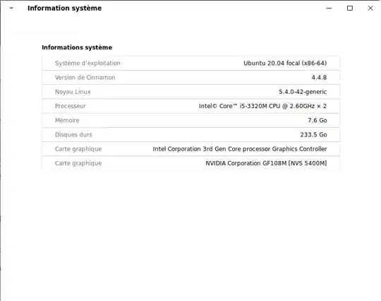

My computer's OS and desktop environment are:
  • Ubuntu 20.04 (focal) 64 bit
  • Cinnamon Desktop 4.4.8
Here is a screenshot of my system (sorry, it's French, it's ok if you don't know french to see it):
My screenshot of system info
The latest version of Cinnamon is 4.6.6, and I want to update to that version. My question is simple: How can I update to Cinnamon 4.6.6 without reinstalling Cinnamon?

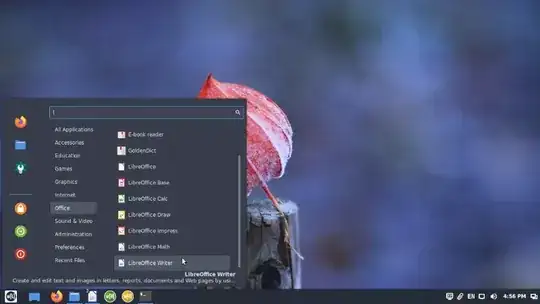

I found a PPA maintained by the developers of Wasta Linux (a derivative of Ubuntu, featuring the Cinnamon desktop).
Since they maintain an operating system, I would trust the PPA built by them.
cinnamon 4.8 Image source
sudo add-apt-repository ppa:wasta-linux/cinnamon-tagged
sudo apt-get update
sudo apt dist-upgrade
Currently the PPA hosts Cinnamon 4.8 for Ubuntu 20.04.
