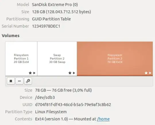

At install, I thought that 20GB would be enough for root, and allocated first 20GB to root, then 30 GB swap and then the rest to /home.

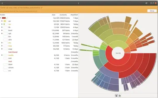

Now the OS is telling me it's low on disk space on root but I don't know what can fill it up really as 20GB for an OS without the user's home should be plenty. Unfortunately I can't seem to see what's filling up root as the GUI utilities (Disk Usage Analyzer) provide little insight.
I tried to shrink the /home via Disks and I can't. Neither the swap. So the question is:
How can I shrink any of the /swap or /home so that to make free space to enlarge the root on a live system? I can't boot into live environment because I don't have physical access to the machine, only remote! Please don't tell me I can't do this without a reboot or a boot into a live USB! I come from macOS world and there is no problem resizing a partition on a live system.
Here are some screenshots if it helps!
