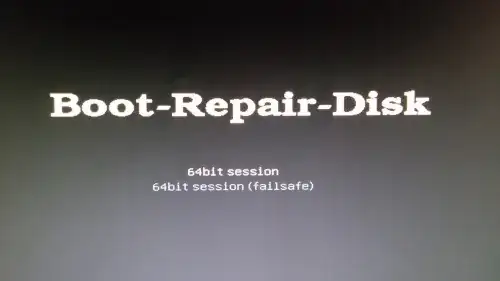

  1. Go to the page, click here and download BOOT-REPAIR-DISK.
  2. Burn it to the DVD disk or make a USB Bootable no more than 4GB and USB 2.0 (I recommend the DVD disk 4 GB).
  3. Power on the PC with the DVD disk or USB bootable inserted.
  4. Once the screen displays the title "Boot-Repair-Disk", there are two options that you have to choose. Click the first, the upper 64bit session.
  5. Once the screen displays the desktop, it will display about the updating Boot-Repair-Disk, click NO because it's not necessary.
  6. Once the screen displays two options that you have to choose as the following picture displays, click the first Recommended repair (repairs most frequent problems)
  7. Once finished the process, reboot the PC and it must boot up the Ubuntu OS.
That's all. Good Luck!

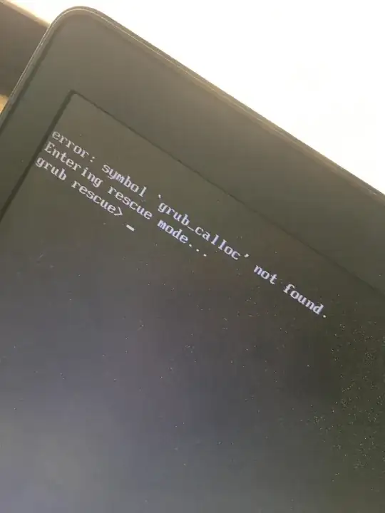

The Surprise:
After a recent update, I got the same error:
error: symbol grub_callocnot found .
Entering rescue mode ...
grub rescue> _

I was hoping for a bug fix to come soon, as this bug leaves the system unbootable and unusable. Meanwhile, I could still boot both into Windows 10 and Debian 10, by,
  1. going into "'BIOS' setup" by pressing ESCAPE when the laptop is started,
  2. and then selecting the option "Boot from EFI file" instead of "Boot from OS Manager",
  3. and then from the folders Boot, debian, HP and Microsoft going into debian,
  4. and then selecting the grubx64.efi file,
which would bring up the usual grub menu with the usual OS choices listed. Maybe this option is something specific to my laptop, I cannot say. (Something similar could be arrived at, through the use of a Live USB/CD as well, I guess).
The Fix that worked:
Anyways, after waiting for a week or so, for the bug fix, I got tired of this routine of going through the BIOS Setup to boot the laptop every morning. After booting up into Debian 10, this morning, I did the following:
  1. I looked into what is in the Boot folder under EFI, where I found only one file bootx64.efi.
  2. I made a backup of the bootx64.efi file ---> bootx64.efi.bak placed in the same folder.
  3. Then I copied over the grubx64.efi from the debian folder, into the Boot folder as the new bootx64.efi.
  4. Rebooted the laptop and up came the grub menu, clean and clear, without any jumps through any hoops.
I guess the same could be done from a live USB/CD also.

I hit this error upgrading a bunch of servers from Ubuntu 16.04 to 18.04. In my case one machine had a separate boot volume that was on /dev/md0 (mdraid array) which used /dev/sda1 and /dev/sdb1 as RAID volumes. The fix was:
  • Boot from an 18.04 USB stick into "LiveCD" mode.
  • Use blkid to find the volume UUIDs and drives. Identified /dev/md127 as the mdraid array that usually appeared as /dev/md0.
  • Then:
    apt install grub2-common grub-pc
    mkdir -p /mnt/root/boot
    mount /dev/md127 /mnt/root/boot
  • Install MBR on both physical drives so either will work after a failure
    grub-install --root-directory=/mnt/root /dev/sdb
    grub-install --root-directory=/mnt/root /dev/sda
  • Verify that there are new grub files in /mnt/root/boot/grub:
    ls -alR /mnt/root
  • Reboot
After that the server came back up.
