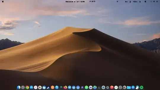

You should see my setup first. I customized Gnome to look like mac

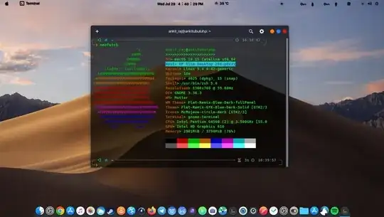

I even changed the name to macOS catalina but I don't know how to change the
Host> HP Slim Desktop 290-p0xxx
and that tiny ubuntu icon in Command prompt.I want to change that icon to "apple" icon.I am using "oh my zsh" with powerlevel10k.
Can anyone help me here?
Freax
  • 155
To replace the Ubuntu logo with Apple logo in Powerlevel10k prompt you need to add the following parameter to ~/.p10k.zsh:
typeset -g POWERLEVEL9K_LINUX_UBUNTU_ICON='\uF179'
