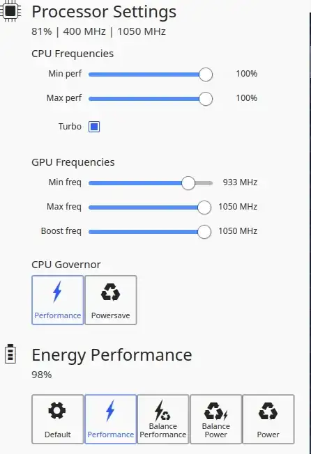

  • I installed the "Intel P-State and CPUFreq Manager" KDE Widget to monitor and adjust everything to high performance with no effect
    Processor settings
