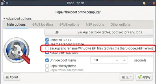

So it turns out, boot-repair has this in the advanced-options. It even has a name: "hard-coded-EFI error".
Strangely however, just this didn't fix it for me. I had to go through a few rounds (yes, somehow one wasn't enough) attempts at Windows repair though the grub options for Windows with Dell. And after a couple of days, windows just boots like nothing happened.
I was almost on the verge of resetting the Windows itself, but I backed off last minute because I was not sure if the reset would remove my linux partitions as well. So it just did a boot repair from Windows again and after that I was able to boot.
Can't be conclusive what worked. But, a boot repair advanced option and few runs of Windows boot repair can't do much harm.
