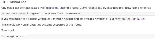

I know that this is an old question, but if you came to the question more recently the correct answer is now in the official docs
Offical Docs
And here is my version of using it:
echo Download the installer script
export DOTNET_INSTALL_SCRIPT=/tmp/dotnet-install.sh
wget https://dotnet.microsoft.com/download/dotnet/scripts/v1/dotnet-install.sh -O $DOTNET_INSTALL_SCRIPT
chmod --verbose u+x $DOTNET_INSTALL_SCRIPT
echo Run the installer script for the GA release of .net 7.0 $DOTNET_INSTALL_SCRIPT --quality GA --channel 7.0
echo set up the paths export DOTNET_ROOT=$HOME/.dotnet export PATH=$PATH:$DOTNET_ROOT:$DOTNET_ROOT/tools
echo install and run gitversion dotnet tool install --global GitVersion.Tool dotnet-gitversion /updateprojectfiles
running the script
