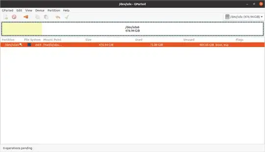

I installed Ubuntu in dual boot with win10. When I tried to remove win10 and be in single boot (Ubuntu), My Grub menu didn't recognize the Ubuntu, and I can't boot into Ubuntu now.
My partition
I can boot into the flashed USB drive that I used to install Ubuntu, so the problem is not in the grub menu. I tried to rub the bot-repair tool, but I got an error: GPT detected. Please create a BIOS-Boot partition (>1MB, unformatted filesystem, bios_grub flag). This can be performed via tools such as Gparted. Then try again.
I also used (parted) print command, and this is the output:

Number Start End Size File system Name Flags 6 1049kB 512GB 512GB ext4 boot, esp
I don't want to reinstall Ubuntu, but I will if it will be the only option.
EDIT: I accidentally deleted EFI system partition...

From what I can gather, it seems that there was a small partition for grub that contained some data which allowed Ubuntu to be detected. The error message you're getting sounds like somehow this partition was removed, most likely when you removed Windows 10. The question/answer I linked to below talks to this if that's of interest to you.

Notice that I have a separate partition for the EFI boot, mounted at /boot/efi
Additionally, I've found a similar, if not exact question that's been answered here before stating that you need to make sure to boot the recovery disk in UEFI mode instead of Legacy/BIOS mode among other things.
