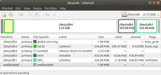

The only thing that changes on a mkusb persistent USB is the persistence partition, casper-rw (nowadays labeled writable) and the NTFS usbdata partition.
With mkusb the system partition is read only and can't be corrupted. Mkusb comes with an option for making backups of your home folder, the most likely item to get corrupted.

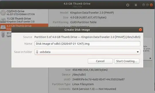

It is also possible to make a backup image of your writable partition using the included Gnome-Disks and then store the image in mkusb's usbdata partition, so that the persistence partition can be reset, (overwritten), as needed. Just boot using mkusb's toram mode when overwriting partitions.
