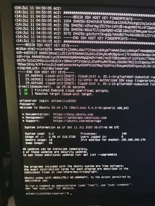

Needed help, I've tried commands but still not continuing to the desktop. badly needed help.
Ubuntu Server 20.04

If you installed Ubuntu Server, the command prompt you show in the photo is perfectly normal. A graphical desktop environment is not installed by default.
Either you can reinstall Ubuntu (the normal desktop version) and setup your server applications from there, or you can install a graphical desktop on top of your existing installation as follows (I'll just give you an example for Gnome, if you want anything else the internet is full of help :) ).
Run the following commands from the command line:
sudo apt update
sudo apt upgrade
sudo apt install tasksel
sudo tasksel install ubuntu-desktop
sudo reboot
You should now be shown a graphical login screen!

You have installed the Ubuntu server version which does not include a desktop by default. So all operations you want to perform would be via a CLI (command-line interface) which is what the primary focus of a server type environment is.
Easiest thing you can do if you don't have CLI expertise
Download a Ubuntu Desktop version from Ubuntu website https://ubuntu.com/download/desktop and reinstall it.
Alternate method through shell prompt
Start by updating the repositories and package lists:
sudo apt-get update && sudo apt-get upgrade
Next, install the tasksel manager utility:
sudo apt-get install tasksel
Choose a display manager. Many options are available from lightweight to high function desktop environment. Below is an example of Xubuntu - a moderately lightweight GUI for ubuntu
E.g. Install Xubuntu by entering the following:
sudo tasksel install xubuntu-core
Launch your desktop by
sudo service display_manager start
If you need to stop the desktop and return to the terminal shell
