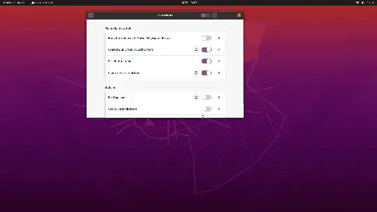

There is a extension for Hibernate Button in the Power Menu.
Hibernate GNOME-Shell extensions
Out of the box there is no effect when you click on the two items, Hibernate and Hybrid Sleep..
If you go to the Extension Homepage link provided on gnome extension website for the Hibernate Extension you will find FAQ part on the README.md
Following the workaround from the FAQ.. copy paste the below content in the file /etc/polkit-1/localauthority/10-vendor.d/com.ubuntu.desktop.pkla
