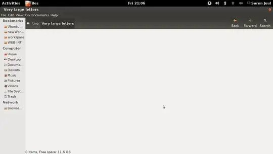

After upgrading to 12.04 my fonts are now huge. The only way I have found to solve it, is by running the following command after startup:

Can somebody help solve this problem?
Update 2: I have the same problem in unity
Update 1: Attached screenshot:

Try to install gnome-tweak-tool via terminal:
sudo apt-get install gnome-tweak-tool
Then start it with
gnome-tweak-tool
on terminal and go to font settings. Set the fonts to "Ubuntu" with font size "11" and for window titles "Ubuntu Bold".
By the way: What you describe should be a bug, but with this workaround you can get your fonts set to default.
