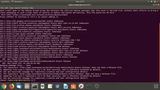

I had a problem with installing Octave. Now I am unable to close it once it is opened. And I am unable to shutdown the computer. What path should I set, what /etc/environment should I set?
I had used these commands to install:
$ sudo apt-add-repository ppa:octave/stable
$ sudo apt-get update
$ sudo apt-get install octave
$ octave
You got this error message:
E: The repository 'http://ppa.launchpad.net/octave/stable/ubuntu bionic Release' does not have a Release file.
ppa:octave/stable does not support Ubuntu 18.04, so remove it from sources.list and install the octave package from the default Ubuntu 18.04 repositories instead. Open the terminal and type:
pkill octave
sudo add-apt-repository --remove ppa:octave/stable
sudo add-apt-repository --remove ppa:mc3man/trusty-media
sudo apt-get update
sudo apt purge octave
sudo apt install octave
