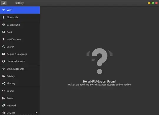

I bought a new laptop Lenovo S540 and tried dual booting it with windows 10 and Ubuntu 18.04. The dual boot went fine and after I updated the Ubuntu system my wifi icon got disappeared from top-right menu and in settings, it shows "No wifi adapter found"
I already tried some of the methods posted online but none of them worked till now.
