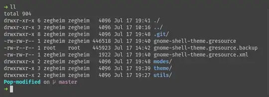

My workflow is as follows:
extract / edit / compile in ~/.local/share/gnome-shell/theme/Pop-modified, which is under version control (see below):
dedicated folder for editing files; trac
To apply the changes, I run the following command:
sudo cp ~/.local/share/gnome-shell/theme/Pop-modified/gnome-shell-theme.gresource /usr/share/gnome-shell/theme/Pop-modified/gnome-shell-theme.gresource
which is where gdm3-theme.gresource is pointing to, using update-alternatives (see below):
➜ update-alternatives --config gdm3-theme.gresource
There are 3 choices for the alternative gdm3-theme.gresource (providing /usr/share/gnome-shell/gdm3-theme.gresource).
Selection Path Priority Status
0 /usr/share/gnome-shell/theme/Pop/gnome-shell-theme.gresource 20 auto mode 1 /usr/share/gnome-shell/gnome-shell-theme.gresource 10 manual mode
  • 2 /usr/share/gnome-shell/theme/Pop-modified/gnome-shell-theme.gresource 0 manual mode 3 /usr/share/gnome-shell/theme/Pop/gnome-shell-theme.gresource 20 manual mode

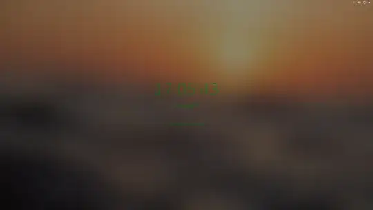

As an example, concentrate on the text "green" in the below content..
/* Screen Shield */
.unlock-dialog-clock {
  color: green;
  font-weight: 300;
  text-align: center;
  spacing: 24px;
  padding-bottom: 2.5em; }
screenshot with green text
In your case, the .gresource file you have edited is not used by the lock screen..
For the lock screen, which .gresource or css file is used, varies from your OS rather than simply gnome 3.36
See this answer for further information.
