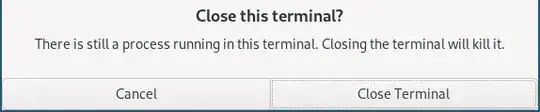

When you open gnome-terminal without any options and execute a blocking command (e.g. python3, vim or cat) and then try to close the window by the close button (i.e. x button in the title bar) or some keyboard shortcut, a confirmation window is displayed:
However, when you open gnome-terminal with an executed command specified, that is, in the form of gnome-terminal -- python3, the confirmation window is no longer displayed and the window is closed right after you (accidentally) click the close button.
Is it possible to show the confirmation window even when you use the form gnome-terminal -- <command>? If that's impossible, is there any workarounds?
