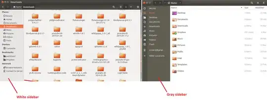

On my Ubuntu 18.04 LTS system, I replaced Nautilus with Nemo 4.2.3, because it has more useful features. However I had to admit that Nautilus "skin/theme" is more beautiful to me, when I use Ambiance theme.
I would like to customize Nemo skin to be similar like Nautilus, including the gray sidebar.
I made a comparison:

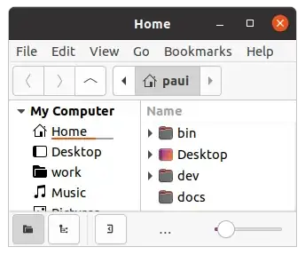

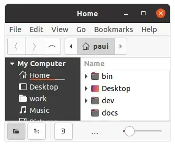

Pre ModificationPost Modification
