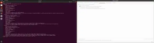

Please see attached screenshot of lshw -c net and additional drivers:
here

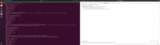

Edit: I turned my PC back on and disabled the built in Wifi from the Bios. This seems to have given me just the network card please see attached image for lshw -c net output and device drivers:
lshw -c net
