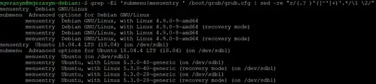

I have to Linux dist installed on two separate HDDs, currently I' m working from home so sometimes need to switch OS back and forth. I tried all these steps from this link:
Set “older” kernel as default grub entry
but nothing works for me.
Each time Debian 9 Stretch being loaded. How can I switch to Ubuntu OS ?
Here is my setup

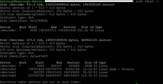

Here is the disk configuration. I need to boot OS from /dev/sdb1.

In my case I have to HDD:
  • /dev/sda - Debian
  • /dev/sdb - Ubuntu.
Both of these have their own copy of /boot/grub/grub.cfg. Let's say I login to Debian now, it means all commands like sudo grub-update sudo grub-set-default x
etc. will affect grub.cfg of Debian dist currently running.
Taking into account, that I don't know order of executing of these two versions of grub.cfg. I decided to change line with set default="Desired OS", in my case set default="Debian GNU/Linux 9 (stretch) (on /dev/sda3)"
for BOTH these grub.cfg.
