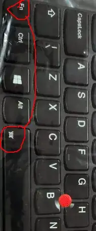

I am currently running Ubuntu 20.04 on a Lenovo E595 laptop. I swapped out the physical keyboard with one that is backlit (confirmed by the presence of the "key" light label on the spacebar). The connectors do physically line-up (The only difference is that the backlit keyboard ribbon cable runs a couple extra traces in already existing plastic). The issue is that I cannot activate the backlight at all.
My question is if I can turn it on, what is the way to do so.

  5. Press "Fn + Space" (which is the logical thing to do)

  5. Linux is reading the Fn key as a keypress instead of allowing the firmware (if any) to use it as a modifier key. This can be seen running the showkey command. For me, it returns a value of 143. This could be leveraged, if there was another way to adjust the backlight manually.

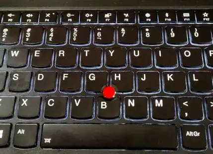

In some cases you will not find tpacpi::kbd_backlight That was my case, I hava a Lenovo/Thinkpad T480 20L6 which "does not have" support for keyboard backlight. However after some time I bought a keyboard with backlight support ---> new keyboard with backlight
However, even after installation and reboot, the backlight led did not work. But now, the problem was the BIOS. So I've entered in Lenovo support site and downloaded the BIOS Update Utility (Linux) v1.45 from 23 Aug 2022. It gave me a zip file. Once decompressed, I just ran sudo fwupdmgr install N24ET70W.cab. But still did not work flawless, I had to edit the file /etc/fwupd/daemon.conf and turn to false the key OnlyTrusted=false, then I ran the fwupdmgr command again, restarted the machine, and finally it worked!
new keyboard with backlight working
