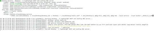

The DNS cache program unbound was running on port :53 and preventing dnsmasq from starting. I uninstalled unbound and dnsmasq starts now. However it's saying it's only running on 0.0.0.0 for some reason. I figure it has to be running on 127.0.0.1:53. I reinstalled dnsmasq but it's acting the same. /etc/dnsmasq.conf is all commeted out. On restart /etc/resolv.conf is now set to
# Generated by resolvconf
nameserver 127.0.0.1
Not sure how to get dnsmasq running properly.

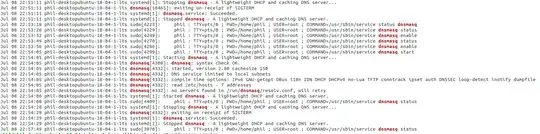

journalctl -e --unit dnsmasq.service
-- Reboot --
Jul 08 23:41:54 phil-desktopubuntu-18-04-1-lts systemd[1]: Starting dnsmasq - A lightweight DHCP and caching DNS server...
Jul 08 23:41:54 phil-desktopubuntu-18-04-1-lts dnsmasq[7349]: dnsmasq: syntax check OK.
Jul 08 23:41:54 phil-desktopubuntu-18-04-1-lts dnsmasq[7369]: started, version 2.80 cachesize 150
Jul 08 23:41:54 phil-desktopubuntu-18-04-1-lts dnsmasq[7369]: DNS service limited to local subnets
Jul 08 23:41:54 phil-desktopubuntu-18-04-1-lts dnsmasq[7369]: compile time options: IPv6 GNU-getopt DBus i18n IDN DHCP DHCPv6 no-Lua TFTP conntrack ipset auth DNSSEC loop-detect inotify dumpfile
Jul 08 23:41:54 phil-desktopubuntu-18-04-1-lts dnsmasq[7369]: read /etc/hosts - 7 addresses
Jul 08 23:41:54 phil-desktopubuntu-18-04-1-lts dnsmasq[7369]: no servers found in /run/dnsmasq/resolv.conf, will retry
Jul 08 23:41:54 phil-desktopubuntu-18-04-1-lts systemd[1]: Started dnsmasq - A lightweight DHCP and caching DNS server.

I figured it out. Everything was commeted out in my /etc/dnsmasq.conf. I had to set the dns server.
/etc/dnsmasq.conf
server=8.8.8.8
/etc/resolv.conf
These commands were helpful debugging
sudo systemctl status dnsmasq #dnsmasq should be running
sudo netstat -tulpn #dnsmasq should be listening on 0.0.0.0:53
nslookup debian.org localhost #should return IP address of debian.org
