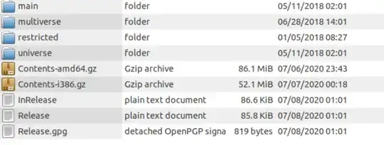

I maintain a local mirror of Ubuntu Bionic so I can show you the size of the files.
This is the baseline 18.04 release from 4/2018. As you can see, the zipped 'Contents' files are ~37 MiB each.
the security and updates contents list are roughly twice as large (this is bionic-updates).
The unzipped Contents-amd64.gz from the baseline is nearly 600 MiB and contains 6,552,333 lines. It starts like this:
