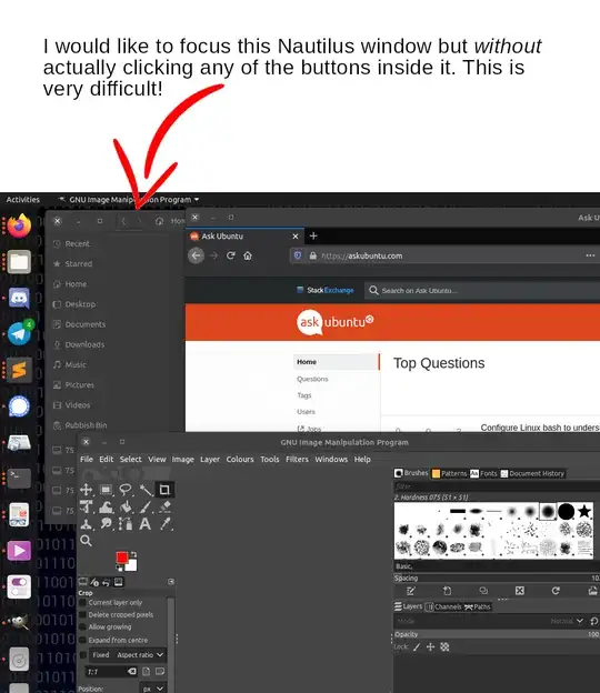

I would like to configure Ubuntu 20.04 (with Gnome shell) so that if I click a window which does not have focus, that click raises the window and does nothing else; in particular, that click to raise the window does not actually have an effect on the window (so I can click where a button is without activating that button). In the old days on the Mac this, clicks triggering actions in background windows, was called "click-through"; it's the default in GNOME Shell and I'd like to disable it.
The reason for this is that it is very hard to click on a window to raise it without also clicking on a button inside it!
A Nautilus window mostly covered by other windows
Almost all the visible areas of that Nautilus window are "active" areas in some way; clicking in that window to focus and raise it will also change the folder that it is currently displaying.

I think, short of a code change, you can't. I'm basing that on the following.
Judging by https://github.com/GNOME/gnome-tweaks/blob/35e3a5bebebb94a631e5ccbb7c29b2e482595a9a/gtweak/tweaks/tweak_group_windows.py#L20-L21 the setting is org.gnome.desktop.wm.preference, and the key is focus-mode. That lead to https://github.com/GNOME/gsettings-desktop-schemas/blob/2bb055b3c1b87e6db80d891bd788f1d4b9a62af3/schemas/org.gnome.desktop.wm.preferences.gschema.xml.in#L41-L50, which indicates there are only three possible values
“click” means windows must be clicked in order to focus them,
“sloppy” means windows are focused when the mouse enters the window, and
“mouse” means windows are focused when the mouse enters the window and unfocused when the mouse leaves the window.
I think the answer is still no on this one.
a workaround:
holding the click while doing a pixel's worth drag(just until the grab-hand appears)...
it's wack.. but it won't activate the button when you let go.
