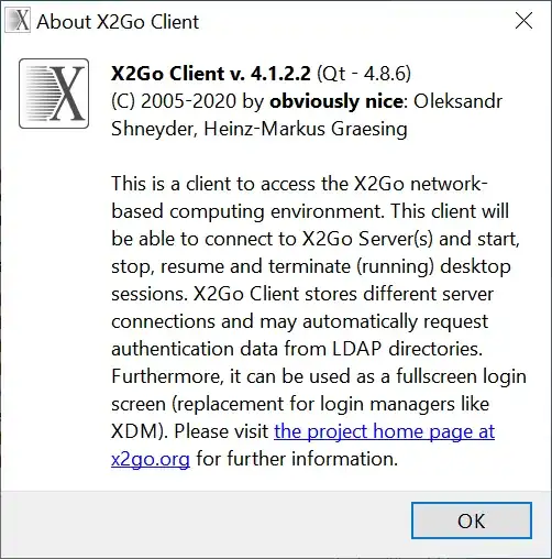

I am using this windows client to access Ubuntu:
When I reconnect, clipboard usually works, but some time later it usually stop working. But clipboard I mean copying in windows and pasting in Windows. This is version of my server: 4.1.0.3-0~1708~ubuntu18.04.1. Are there any related known issues? I was not able to google anything, but this happens regularly and reproduces for other developers in my team.
