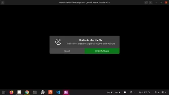

I often download youtube videos to watch them later. But some of them does not show any thumbnail and if I try to play them in smplayer it only renders audio and doesn't support video. When I try to open them with ubuntu default video player error message is showing up as shown in the image.
AV1 decoder not found error
On clicking on find in software it doesn't find anything. I have already installed ubuntu restricted codecs. I know vlc can play this but vlc has other playback issues for me. It is playing in mpv but I want to use smplayer. Any workaround to play this type of video in smplayer? Thanks in advance.
