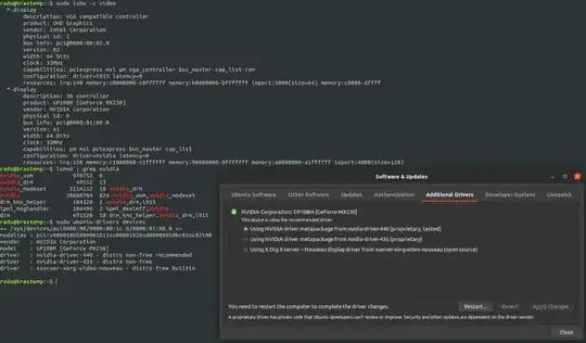

I have a i7 10th with a MX230 GeForce. I have installed only Ubuntu 20.04. During Ubuntu's installation, I did this to install NVIDIA drivers. The current configuration is:
I can play video games and so on, but every time I try to use the brightness keyboard shortcuts, my entire UI is frozen for a little while(10s). Decreasing the brightness works fine (besides the 10s UI freeze), but trying to increase it freezes it longer than 10s and after it unfreezes, it behaves as nothing happened. I cannot fail any new attempt to solve this since I have important data into this machine. I've found these options:
