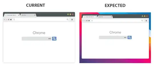

Is there a way to set the maximum allowed size for maximized windows?
Let me explain, I wish that the maximized windows do not cover the entire desktop, but I can set a margin or area to leave a part of the desktop visible.
For example:
I found a program that does exactly that but only for windows: Change The Maximum Window Size - gHacks Tech News. I imagine there must be something similar for Linux but I can't find it.
