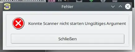

I'm trying to scan a document with a Epson ET-2750-Scanner using xsane. I always get the errorcode: "Invalid argument".
Printing with the ET-2750 works fine, just scanning doesn't. I've tried connecting it over USB or Wifi, it doesn't make a difference.

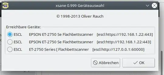

xsane finds the printer:
But it can't scan:
What do I do?

  2. For me, the error you describe goes away, when I do a preview scan first. This is my answer to your original question. But if you, like me, tried to get the thing to scan under Linux, be my guest for the odyssey in the rest of this post. I imagine that it'll be very similar to your printer/scanner.
  3. BXSane usually crashes with a segfault while writing the results (using PNG target format). It did work once, but I've had many crashes.
  4. Scanning without saving worked at 300DPI but never at 600DPI or higher. I didn't try all resolutions. At 600DPI I get the same error message (invalid argument, ungültiges Argument) after the scan finishes.
Then I installed Epsons imagescan packages (available at http://support.epson.net/linux/en/imagescanv3.php). I had to configure a suitable /etc/imagescan/imagescan.conf by adding the correct IP to the default file and uncommenting the relevant lines.
After that, another scanner is found by XSane. The label depends on what you enter into the aforementioned conf file.
With this backend, XSane even allows using the document feeder (ADF) as input, not only the flatbed. But it doesn't let me select the resolution at all. And the multi-page interface of XSane is ...uh... sub-optimal.

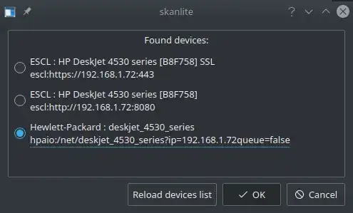

I have a similar problem with Hp Deskjet 4535 and Skanlight.
Selecting the ESCL options I have problems with 600 DPI and up.
Selecting the specific one (Hewlett-Packard) I have no problem.
Notes
  • Seldom I've to reload the device list in order to make appear the option below.
  • Additional features appear in Skanlight such as brightness and contrast controls...
