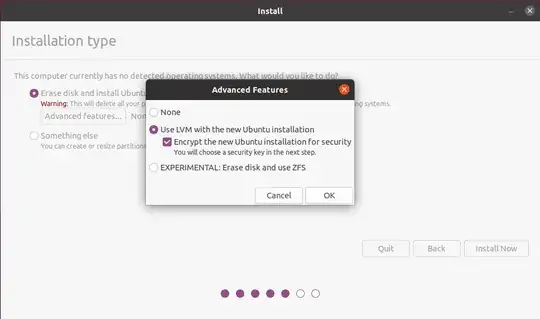

They have done a good job of hiding encryption options in the Live installer. It is located on the install page, just above Something else.
Tag "Erase disk and install Ubuntu" and then click "Advanced features". The Advanced Features popup will popup. Click "Use LVM with the new Ubuntu installation" and then "Encrypt the new Ubuntu installation for security".

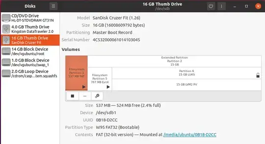

A USB created with the above method will only boot in the BIOS/UEFI mode it is created in. For a USB that Boots in either mode:
  • When Install is complete, open the 20.04 ISO file and copy boot and ESP folders to partition 1.
  • Copy grub.cfg from Partition 5 /boot/grub/ to Partition 1 /boot/grub/ overwriting the existing grub.cfg file.
  • Re-Install GRUB:
    sudo mount /dev/sdb1 /mnt
    sudo grub-install --boot-directory=/mnt/boot /dev/sdb
  • Encrypted Full install USB should now be working in BIOS and UEFI modes.
