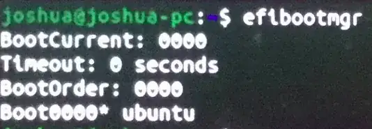

Please try and help me, what ever information you have. I have been stuck with this over a month. I have a HP Probook 640 G1 with UEFI without CSM and secure boot off. I have recently installed Ubuntu 20.04. It worked but every time I boot it says System BootOrder not found. Initialising Defaults. Then it semi resets the system and then boots to Ubuntu.
Is there a way to fix the initialisation of the defaults, because it significantly increases the boot time.
Thanks
Picture of efibootmgr:
Click Here

efibootmgr
Regarding the boot problem... let's change the boot timeout from 0 seconds to 1 second.
  -t | --timeout seconds
          Boot Manager timeout, in seconds.
         • Timeout  -  the  time in seconds between when the boot manager
            appears on the screen until when it automatically chooses  the
            startup value from BootNext or BootOrder.
In terminal type:
sudo efibootmgr -t 1
reboot

For reference purposes, here's my efibootmgr output... I do have Windows installed...
~$ efibootmgr
BootCurrent: 0005
Timeout: 1 seconds
BootOrder: 0000,0004,0007,0008
Boot0000* ubuntu
Boot0001* UEFI: IP4 Realtek PCIe GBE Family Controller
Boot0002* UEFI: IP6 Realtek PCIe GBE Family Controller
Boot0003* UEFI: MKNSSDRE1TB
Boot0004* UEFI:CD/DVD Drive
Boot0005* Windows Boot Manager
Boot0006* UEFI: TOSHIBA
Boot0007* UEFI:USB Device
Boot0008* UEFI:Network Device
  • You can try turning off TPM and see if that changes anything.
  • I'm told, but can't confirm, as I don't have a HP, that HP specifically needs to see Windows Boot Manager... even if you don't use Windows. You can either try to reinstall Windows and see if the initializing message is gone, or you could use efibootmgr to create a Windows Boot Manager entry, but assure that your BootOrder is correct, with ubuntu as the first/only selection. See man efibootmgr for more info.
  • Interesting enough, in my efibootmgr output, BootCurrent: 0005 shows Windows Boot Manager, but I'm booted to Ubuntu right now.

Removed the Windows Boot Manager key that was already there from the windows install for Bios update. Next I created a new key the pointed to shmix64.efi I named that key Windows Boot Manager.
