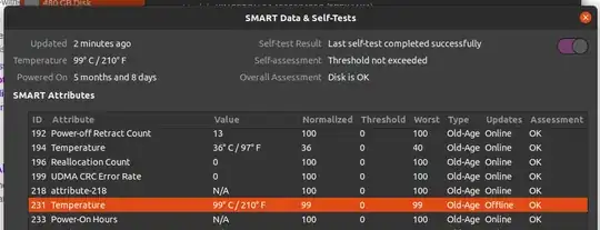

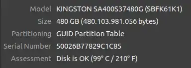

However, at the disks GUI I get a different reading (99°C):
Disks reading
Why is there a difference? which one is correct? can I get a third reading somehow?

edit: digging into the smart self test variables I found this:
I seems there are two temperature readings there, one is 36 like hddtemp and the other is higher
PS: I tried running the self test but it shows an error message: sk_disk_smart_self_test: Operation not supported (udisks-error-quark, 0)
