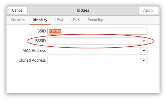

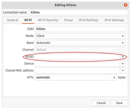

Set the BSSID of the router in the wireless connection script.
Basic service set identifiers (BSSID) is used to describe sections of a wireless local area network or WLAN. It recognizes the access point or router because it has a unique address which creates the wireless network. BSSID identifies the basic service sets that are 48-bit labels and conforms to MAC-48 conventions.
The easiest way to obtain the BSSID of your router, is to connect to it, then use the iwconfig command. The "Access Point" is the BSSID.
Then go to the active Wi-Fi connection profile, pop up the arrow at the end of the BSSID field, and you'll probably see that address already populated. Just select it. In the future, that Wi-Fi connection profile will only connect to your router, not the extender.
If you have more than one Wi-Fi adapter, you can also set "MAC Address" or "Device" to the MAC address of the specific Wi-Fi adapter, if you wish. That will lock that Wi-Fi connection profile to only use that adapter.

Using Wi-Fi Settings...
Or using nm-connection-editor in the terminal...
