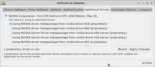

in Software & Updates > Additional Drivers, I chose: Using NVIDIA driver metapackage from nvidia-driver-440 (proprietary, tested)

I had this problem as well and tried several installations with apt-get of different nvidia packages without success. Finally I did go into the drivers management of Ubuntu and did an install from there. Whatever Ubuntu is doing there different, it worked for me afterwards.
Side note: After Kernel upgrade the system gets broken again, because the triggers of drivers/modules do not work well. So I first have to chose a different driver and doing its install and select the wished package again, very annoying.
The command to get this dialog is software-properties-gtk:

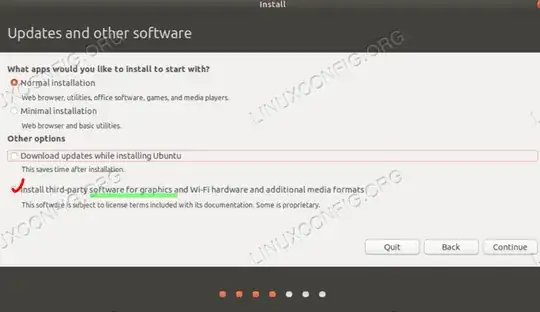

I had the same Graphics and issues with install via Software Updater. Solution was fresh new install and thick box " Instal third party software". Now I am running through Mesa IntelĀ® HD Graphics 630 (KBL GT2) driver.
If you just install restricted-extras without full purge, it won't work.
Let me know if you installed already " Third party software ? I am kind of sure, it wasn't done ;) Just let system choose the right driver.
After that, you don't need to install any other graphics driver. For addition after successful install, you can change your mode to "Powersafe " for better energy management. You should also ensure, your Bios setup has dislable " Secure boot ". Hope it'll works.
