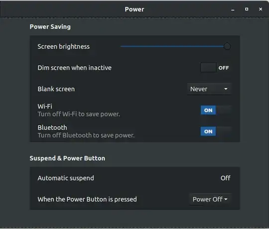

I'm using Ubuntu 18.04 and after update to the latest kernel I can't seem to disable my laptop from going to sleep after a few minutes, even though sleep mode is disabled already. It even goes to sleep when I'm watching a movie, it's annoying.
Here's screenshot of my power setting

If you're using gnome, you can use dconf-editor. You can install it via apt.
For me, it was a similar setting: /org/gnome/settings-daemon/plugins/power/sleep-inactive-ac-type
