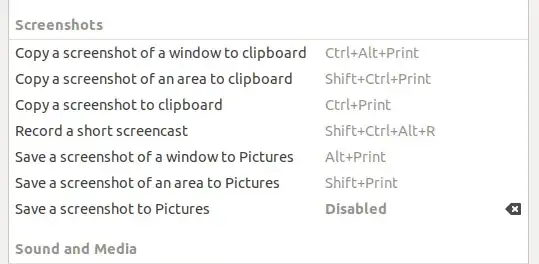

First disable the default screenshot shortcut from settings:
Disable default screenshot shortcut

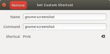

Create a custom keyboard shortcut in the settings:
Name it gnome-screenshot, put the command as gnome-screenshot as well
Shortcut value : enter the key [Print Screen]
Create a custom shortcut:

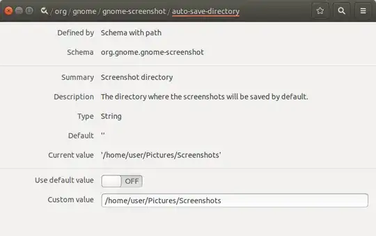

Now enter into dconf-editor (Install it if you do not have it yet). Go to: org -> gnome -> gnome-screenshot -> auto-save-directory: Change the auto save directory's custom value to the one you want.
Enter the custom path:
