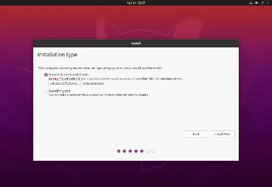

I have Windows 10 on my computer currently and I'm trying to dual boot it with a Linux OS. Following a guide I found online, I have tried installing Ubuntu 20.04 from a bootable USB stick, but during the install the manager doesn't recognize that Windows 10 is already on my machine, so at one point I get a screen like this:

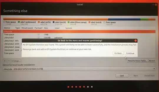

In every example I've seen, there is an option for "Install Ubuntu alongside Windows Boot Manager" (paraphrasing), but the guide actually goes over how to manually partition using the option for "Something Else", so I picked "Something Else" and created the partitions myself. I used the main partition I had made previously to make different partitions for "/" , "/home", and "swap", then hit the "install" button when done. Then, I get an error message saying that "there is no EFI partition on my drive" and I need to make one, like this:
This is odd, because I have looked at a lot of guides on how to partition Ubuntu, but never seen anyone tell you that this file is needed. And while it's actually quite simple to tell the manager to put an EFI file on my drive, the install never actually works. In Ubuntu, the install has failed outright every time. Later on when I tried to install Linux Mint, I actually got it to work with some tinkering, but then I couldn't boot back into Windows.

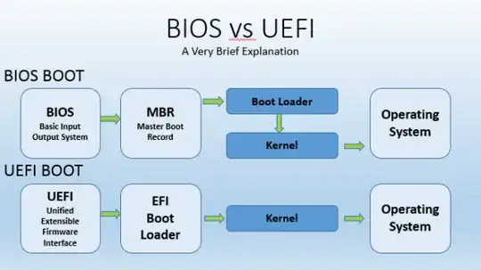

Original poster here - if you have this issue, it is very likely due to Windows 10 being installed in Legacy/BIOS mode, where Ubuntu and Linux Mint are trying to install in UEFI mode. In order to properly dual boot a system, each install needs to be done in the same way; meaning each install either has to done in Legacy/BIOS mode, or each has to be done in UEFI mode. If you do manage to get both of them installed in different modes, it will be near impossible to switch from one OS to the other (so don't try it like I did... haha), because they use different startup paths to boot, seen here:

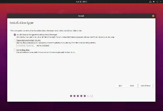

Once you change your disk to UEFI, run the install for your Linux distribution again from your bootable USB. You should actually then see the option for "Install alongside Windows Boot Manager" like this:
You may of course choose this option, or just manually partition the drive with the "Something Else" option if you are comfortable with it. If you chose "Something Else" here, you will not have to create an EFI file as there is already one on your drive now. This should work now for Ubuntu, Linux Mint, and any other Linux distribution trying to install in UEFI mode.
