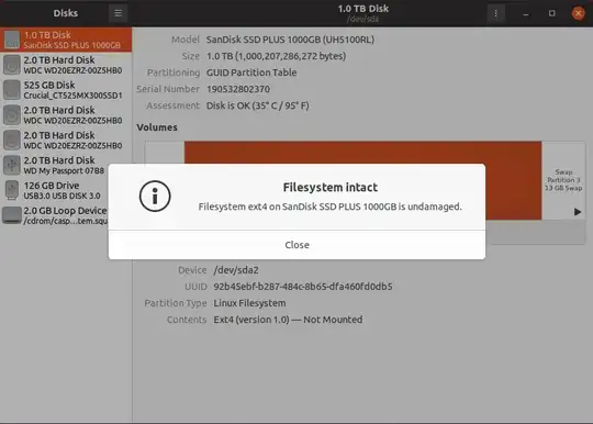

Booting from live CD: output of checking the drive
Additionally, smartctl outputs. I don't seem to be able to get a -t long test to actually finish, but short ones seem fine.

You have NCQ errors. And possible errors on sector 345065452.
Jun 26 10:07:07 mal kernel: [  529.950536] ata1.00: failed command: READ FPDMA QUEUED
Jun 26 10:07:07 mal kernel: [  529.950538] ata1.00: cmd 60/08:00:e8:47:91/00:00:14:00:00/40 tag 0 ncq dma 4096 in
Jun 26 10:07:07 mal kernel: [  529.950538]          res 41/40:00:ec:47:91/00:00:14:00:00/00 Emask 0x409 (media error) <F>
Jun 26 10:07:07 mal kernel: [  529.950539] ata1.00: status: { DRDY ERR }
Jun 26 10:07:07 mal kernel: [  529.950540] ata1.00: error: { UNC }
Jun 26 10:07:07 mal kernel: [  529.852758] blk_update_request: I/O error, dev sda, sector 345065452 op 0x0:(READ) flags 0x3000 phys_seg 1 prio class 0
Native Command Queuing (NCQ) is an extension of the Serial ATA protocol allowing hard disk drives to internally optimize the order in which received read and write commands are executed.
Do this to fix the NCQ errors...
Edit sudo -H gedit /etc/default/grub and change the following line to include this extra parameter. Then do sudo update-grub to write the changes to disk. Reboot. Monitor hangs, and watch /var/log/syslog or dmesg for continued error messages.
GRUB_CMDLINE_LINUX_DEFAULT="quiet splash libata.force=noncq"
