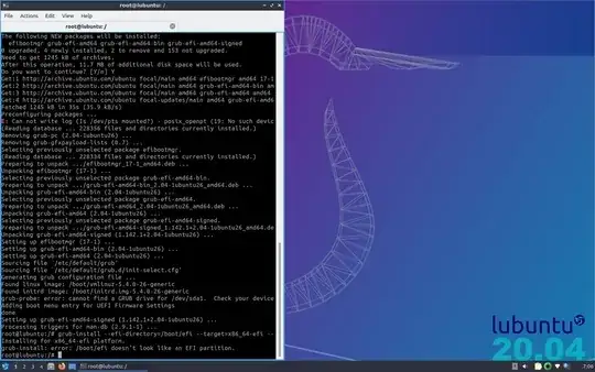

https://askubuntu.com/a/1253617/1098871 is the link to the process I followed.
At step 42 I get an error,
grub-install: error: /boot/efi doesn't look like an EFI partition.
Screenshot error message Help me out with what I should do from here , I'm clueless !

After much fretting, I got a working solution. The solution would be to simple type in sudo mount /dev/sdx2 /boot/efi before attempting to install grub.
