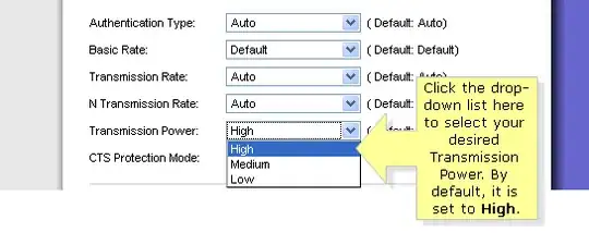

This weak symptom may actually be the fault of the router. Please check to see if there is a setting in the router for TX power:
If so, please try increasing it.
