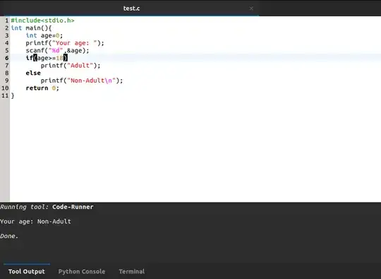

With this I am able to compile and run my last saved C programs. But I am unable to send any value to the program since the output displays on 'Output Tools' of Gedit rather than on Terminal. I also tried various input options from the drop-down menu but none of them worked for me.
Screenshot of Editor with ouput
