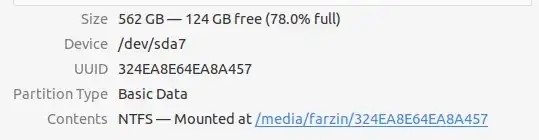

Here is the data of one of my partitions:
Partition Information Screen Capture
Here is the content of /etc/fstab:
