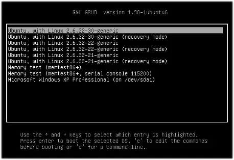

The way Ubuntu should be set up by default in dual boot mode is that you will see a menu for some seconds to choose the OS from.
Shown here for 10.04 LTS and Windows XP but similar in later releases
If you don't see it, make it visible by pressing and holding the left SHIFT key while booting.
  • In case you look for a way to reboot into Windows see this question.
  • For a way to reduce the time until Grub loads the default entry see this question
  • To change the default boot entry have a look at this answer
