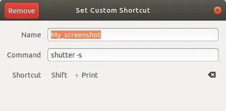

I have created a custom shortcut and bound the shutter -s to it:

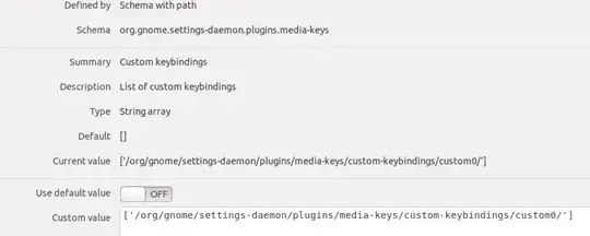

Then I tried to find out where this command is stored and checked settings by dconf-editor. But there are no information about the shutter -s bound command and Shift + Print combination:

Custom shortcuts are stored in dconf using a "relocatable schema". The schema name is "org.gnome.settings-daemon.plugins.media-keys.custom-keybinding". Each custom key binding has three properties: name, command, and binding. Because of the relocatable schema, it is harder to use "gsettings" with custom shortcuts. Here is an example of getting the name of the first custom keybinding:
gsettings get org.gnome.settings-daemon.plugins.media-keys.custom-keybinding:/org/gnome/settings-daemon/plugins/media-keys/custom-keybindings/custom0/ name
Please note, that the last part custom0/refers to the first custom set key binding.
With following command gsettings list-recursively org.gnome.settings-daemon.plugins.media-keys.custom-keybinding:/org/gnome/settings-daemon/plugins/media-keys/custom-keybindings/custom0/ you'll get something like:
org.gnome.settings-daemon.plugins.media-keys.custom-keybinding command 'libreoffice' org.gnome.settings-daemon.plugins.media-keys.custom-keybinding name 'libreoffice' org.gnome.settings-daemon.plugins.media-keys.custom-keybinding binding 'l'
To find the correct entry you might have to increase the number in custom0.
To change e.g. the command use:
gsettings get org.gnome.settings-daemon.plugins.media-keys.custom-keybinding:/org/gnome/settings-daemon/plugins/media-keys/custom-keybindings/custom0/ command '<your command>'
This will also work for name or binding.
To "clear" a custom key binding you could use: gsettings reset-recursively org.gnome.settings-daemon.plugins.media-keys.custom-keybinding:/org/gnome/settings-daemon/plugins/media-keys/custom-keybindings/custom0/- this would clear the entries inside, yet the entry will still exist in the Gnome-Settings as empty entry, but are 'deactivated', sort of.
